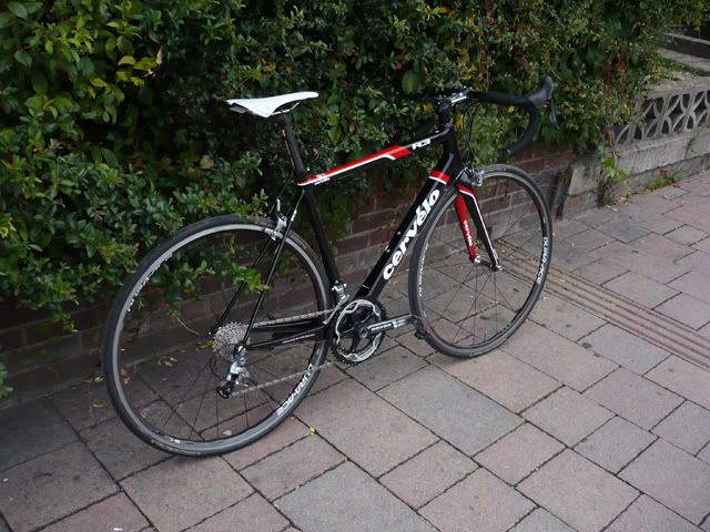

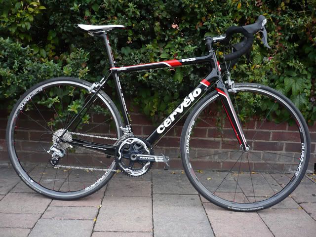

    Having had our 1st drop of 2011 R3's I set about building up the first of our test bikes for a customer to borrow.
    I had read a lot about what I was going to find and what I may need, but going through the process wasn't easy and there were several issues and questions that I turned up. The main one being 'is BB right really bb right?'
    Obviously with any new standard or product there is going to be a degree of 'teething' but with BB right I think only time will tell if Cervelo's move to thier (currently) own standard is a good idea.
    Firstly I completely understand that to improve on the current R3 something had to give. The reason I love Cervelo is that they are always pushing the boundries and BB right is a good move in performance terms. The issue I have is with supply and choice. We have frames on sale in our store, infact I'm in the process of selling one and need to build up our test bike range too.

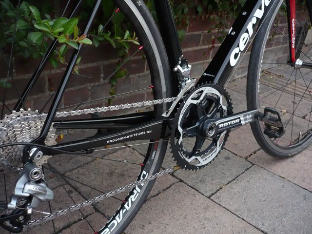

    The first issue I have is what cranks can I fit? I can't find any body who has any idea of what BB right even is let alone buying any cranks from them! Are we really going to be able to easily buy BB right cranks from our local distributor in the future?...really?
    I hunted around and tracked down the only current solution, a load of Rotor 'Cervelo' branded cranks. Nobody has another option, not even an adaptor cup (which defeats the point of BB right anyway, it almost shouting BB WRONG!!).
    So as long as you want to spend £400 on a set of OK Rotor cranks then somebody has to fit them. The frame comes with a BB 'right' push fit BB and that was simple to fit. There is then several washers in a bag. The cranks then came with more spacers, a bolt and a bearing adjuster on the lh crank (like Shimano XTR). There were no instructions, no guidence provided in the box, that woulld have helped. I called the distributor and the Cervelo man there was having similar issues to me (no info etc.) and had no solutions as to how to fit the cranks 'correctly' and how Cervelo intend (their own) standard to be realised!  Why nothing on the website? Why not be prepared? I can't help feeling the frames have just been released too early and/or if BB right is to work then it really needs to be properly supported. It's the same when it comes to the new geometries too! I have no idea if the new R3 has the new geometry!
    After a hour or so I'm pretty sure I've got it right having applied the knowlage of BB30 and Shimano XTR cranks, oh and working out how to remove the cranks during the trail and error process (not obvious without any form or instructions as there is no self-extractor bolt of tool supplied with Rotor cranks).
    I can't help thinking this is silly bad press for BB right, simply because frame can be purchased now. There is a real lack of crank/BB options in the UK at the moment, this may well change in a month or two, but I'd like to know this is going to happen before splashing out on a new frame. Therefore I'm waiting to see what happens before I buy my new Cervelo (it will be a Cervelo) and I'm sure others will too until BB right is up to speed!
    Anyway, the bike looked spot on and the ride is exceptional, really really stiff and reponsive! I want one.
    Here's some pics:
     r31.jpg picture by markakers100
    r32.jpg picture by markakers100
    r33.jpg picture by markakers100
    Here's to the future (:
